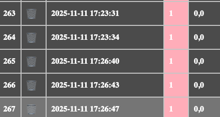

In my screenshot above, you can see between line 263 and 265, there is a gap of over 3 minutes with no recording... THIIS is where the issue is happening.... Cocept2 stops recording data points when you stop.

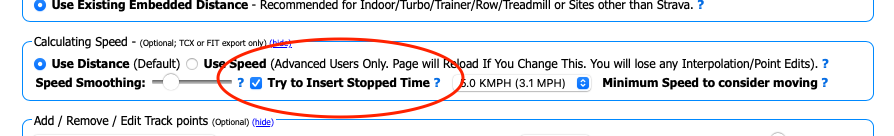

I did also try to play around with your original file by doing some pre-processing on it using GOTOES' "Try to Insert Stopped Time" feature. Basically, I took your Concept2 file, and time-shifted it by one hour. Then when the settings page showed up, I checked the "Try to Insert Stopped Time" and put the speed smoothing relatively low (but not all the way to zero).
Try and Insert Stopped Time
When you click that option, GOTOES will add "activity" start and stops whenever you're missing more than 30 seconds worth of data. Then, you can take the pre-processed file, export it, and merge it with whatever Garmin file you have containing the SPO2 etc. fields.

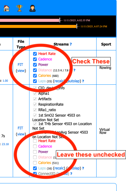

By the way, you don't have to lose the Moxy data fields when using CSV. If you still continue to use CSV files for editing, just take the completed CSV file and upload it to the merge tool in GOTOES alongside the Garmin files that has the Moxy developer data fields. Then, for the Garmin device that has the Moxy Fields, check the "Connect IQ" box which will add them to the list of streams being exported by GOTOES. Then be sure to UNCHECK any of the fields that you worked on in the CSV file from the Garmin file... That way, you will only include the distance, Power, Cadence, etc from the CSV file.. and still get the Moxy data fields from the Garmin file - without the unedited Garmin data interfering.. Let me know if that makes sense...
You can combine an edited CSV file with your original Garmin File to preserve the Connect IQ fields.

For the second issue, did you see the “try and insert stopped time” checkbox? You can check that, and if you want to adjust the stopped time, just fiddle with the “minimum speed to consider moving”. Please note that only FIT supports “stopped time” - neither GPX nor TCX support moving/stopped time. When you see stopped time on one of these file types, whatever viewer you are using needs to apply its own algorithm to calculate the moving or stopped time. Gotoes gives you control over moving and stopped time by letting you adjust the minimum speed to consider moving.
