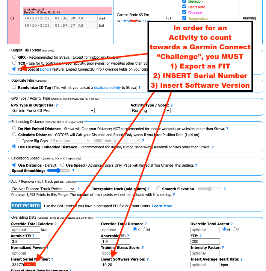

Make sure that you include the Serial Number and the Software Version as well as the correct Garmin Device when you export your FIT file from Strava tools. Doing this will ensure that your activity gets counted towards Garmin Challenges and Badges

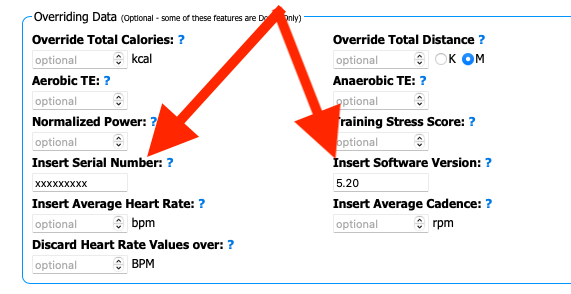

I forgot to enter Serial No and SW Version in the fields at the bottom section of the options page.
Now it works, my merged activities count for the challenges!!

The serial number and software version of your device also show in the table view (assuming they are present in your file). They are colored blue like a link and if you click on them, they will automatically be inserted into the corresponding fields. Seeing the importance of these fields for Garmin Connect, I may automate the insertion in a future release of the tool.
To get an activity to count towards a Garmin Challenge, you Must: 1) Export as FIT, 2) Insert Serial Number, 3) Insert Software Version - these values must come from a Garmin Device.

The key element to see what you want to see in Garmin Connect is that Garmin Connect Requires the following:
1) A Device ID. This is the number that identifies the model of the Garmin device used. For example, a Garmin Fenix.
2) A Serial Number for the device.
3) Only the FIT format supports embedding this type of information.
If you supply this info (and it matches a valid device) then Garmin will show your activity on the challenges.
So, to get it to work, you will need to export from the tool as FIT. Next, you will need to make sure that the Serial Number and Software Version are being inserted into the final file.
Hope that helps!
