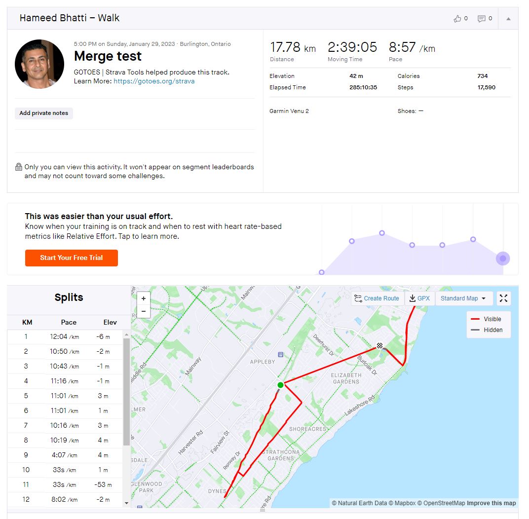

Thanks, but it "messes" up the speed, time and distance as it thinks I "walked" to the park and now my speed seems a lot faster because of the distance covered while driving.

Thanks. I just tried it. The two activities were individually as follows
Activity 1:
Moving Time: 1:03:59
Distance: 6.22 km
Elevation: 25 m
Calories: 206
Activity 2:
Moving Time: 1:32:17
Distance: 8.38 km
Elevation: 17 m
Calories: 528
The merged activity doesn't quite match the sum of the above two activities
Merged Activity
Moving Time: 2:39:05 - this is 7 minutes more than the two activities
Distance: 17.78 km - this is 3.18 km more than the two activities
Elevation: 77 m - this is 35 m more than the two activities
Calories: 1657 - this is 923 calories more than the two activities
The parameters I used were Ignore gaps more than 20 mins and ignore distance more than 5 km. The distance between the start/end of each activity from the other was 4.4 km (Google maps navigation).

Time and distance are still off. Elevation and calories are a lot closer to the sum of the two activities now.
