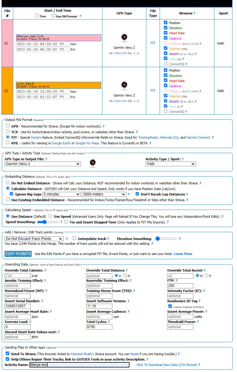

I don't have the checkbox for "Try and insert stopped time"..... see attached screenshot
Re: How to combine two activities that did not start and end at the same location
Yes, you do have that checkbox (it's in the Calculating Speed Box). It is grayed out because you haven't selected FIT.I don't have the checkbox for "Try and insert stopped time"..... see attached screenshot

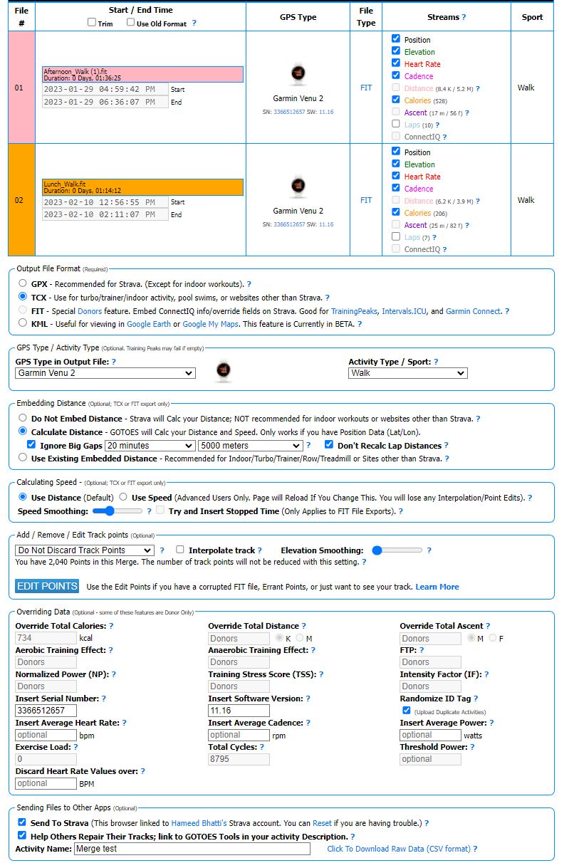

There is no checkbox to "Try and insert stopped time"
nvm! seen it now. thanks!

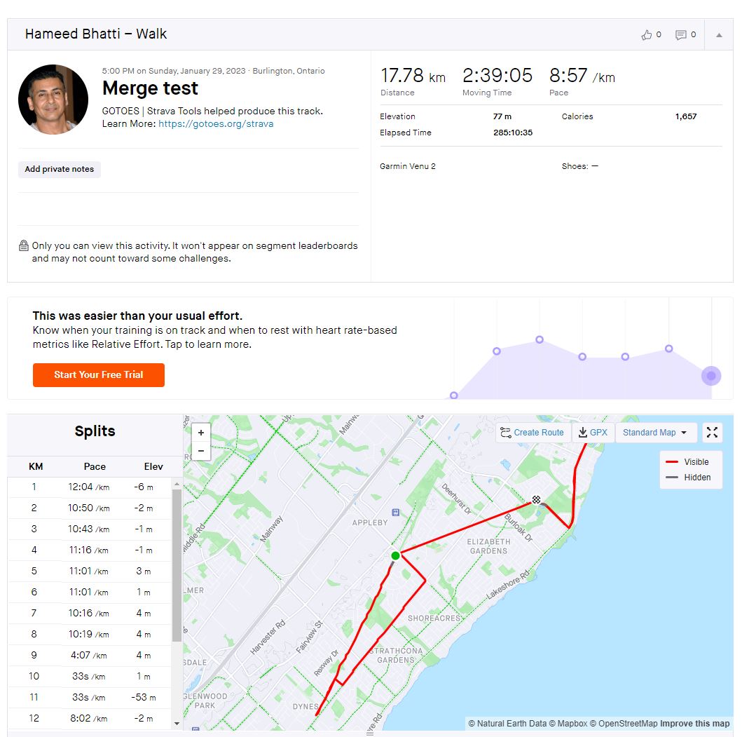

Time and distance are still off. Elevation and calories are a lot closer to the sum of the two activities now.

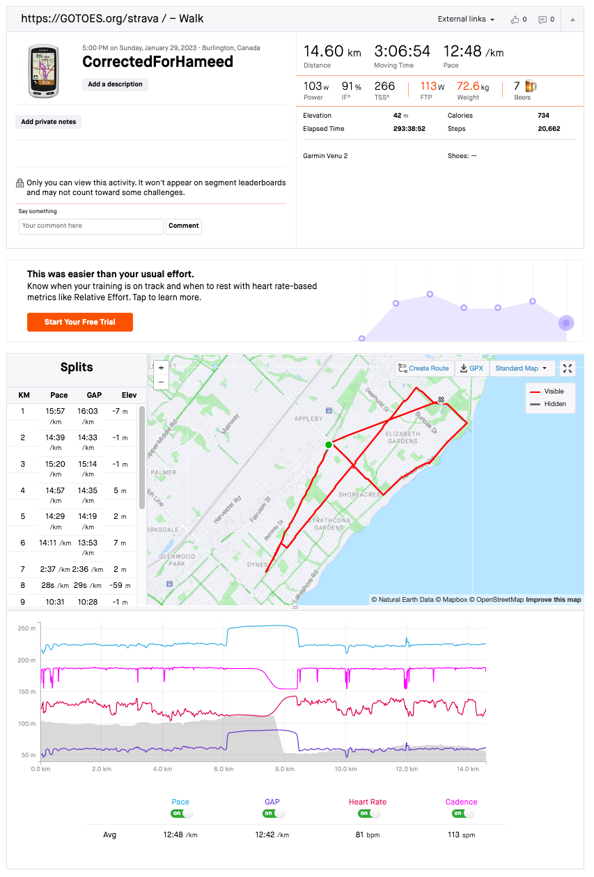

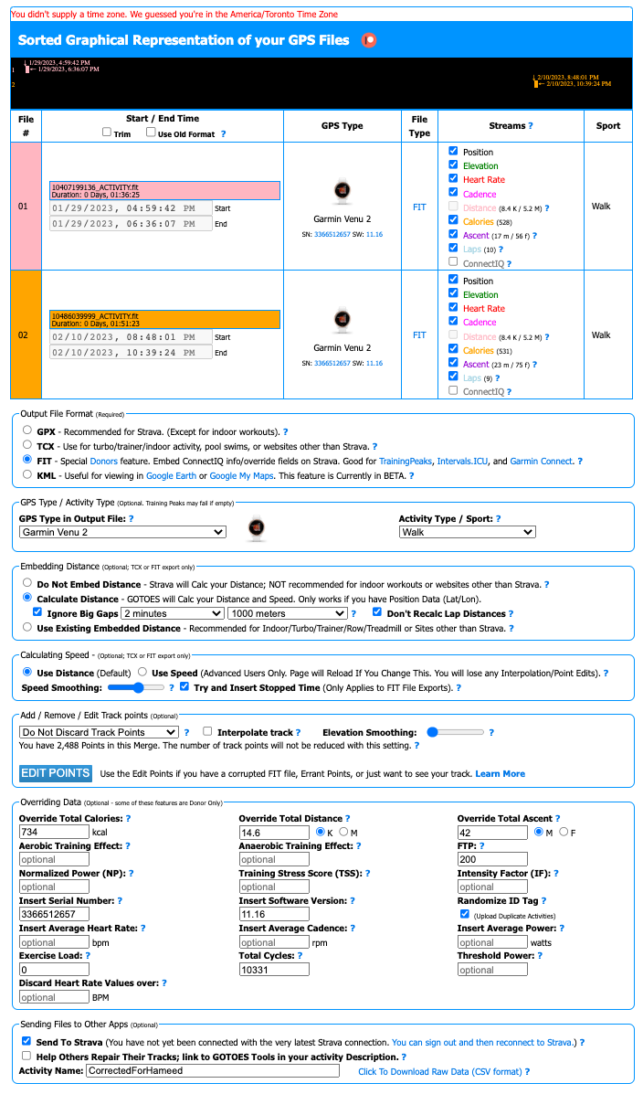

I received your files and removed the email link (for my own privacy). Here are the settings that I used to produce a corrected file for you:
Please look carefully at all of the settings that I selected. Notice that I used the "override distance" and "override calories" and "override elevation" at the bottom to get the stats that you desired. Also, please note that the distances/calories/elevations that you quoted don't match the contents of the actual files you sent me:
The final result looks like this on Strava:
Please notice that calories, distance, and elevation should match the sum of the stats you sent above. Also, note that the Moving time does NOT exactly match what you sent above. The reason for this is because my tool needs to re-factor the moving time when it does the distance calculations. Moving time isn't a clear-cut thing. The reason it is not clear-cut is because of a fact known as "GPS drift." This means that if you're not moving, it is still possible to accumulate "movement" in GPS points. As a result, your GPS has an accelerometer built in that tries to guess if you're really moving or not. Based on that, it will accumulate (or not accumulate) moving time. That works fine for a single activity on the GPS...but my tool needs to re-calculate everything from scratch when it builds one single file from two separate GPS files. As a result, the calculation is not privy to the accelerometer data (that data is not saved)... so my tool has to conduct a "best guess" based on the GPS position (latitude/longitude) instead.
If you really need a perfect moving time, you can repeat my settings above, and play around with the "Smooth Speed" slider... and you can also play around with the "Ignore Big Gap" time (i.e. setting it to something really low - maybe somewhere between 2 and 10 seconds). If you do this, keep the big gap distance around 1,000 meters. This would be a test-and-repeat method where you would keep changing the options until you got what you wanted.... and it is unlikely that you will get EXACTLY what you posted above - but you can probably get it sufficiently close.
The fact that there isn't a match is OK, but that might explain why you weren't seeing what you expected. I went ahead and used the values you sent (quoted above) and used a calculator to add up the totals for what you described as "Activity 1" and "Activity 2".
