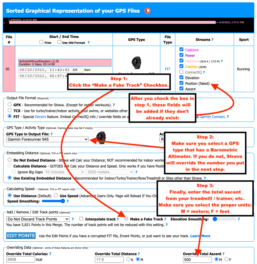

Your question inspired me to add a new feature: A checkbox called "Make a Fake Track"
How to override elevation on Strava when you have an indoor workout.
You will only see the "Make a Fake Track" checkbox if the files you uploaded have distance data. This is because GOTOES needs your distance to compute your position over time. If you do not have distance, but your files do have speed, you can click the "Use Speed" instead of "Use Distance" and the page will refresh - backfilling the distance field for you.
If you check the "Make Fake Track" box, by default, the tool will create a track which is a 1 kilometer circle out in the South Pacific. You will continually go around and around the circle, depending on how much distance you accumulated in your activity. The elevation plot will be flat if the elevation is missing from your file, but you can now enter a number in the "override elevation" checkbox to get a total ascent value in your final file. You also have the option of uploading a custom GPX file to substitute and back-fill position data for your GPS activity file.

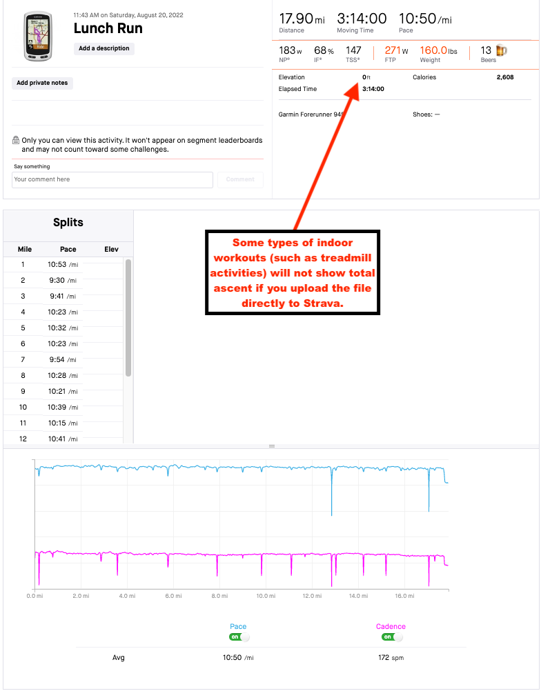

Uploading a virtual activity or treadmill activity to Strava may not show elevation / total ascent.  This is what it looks like before modification with the "fake track" tool.
Here are the recommended steps / settings if you need to override the total ascent from your virtual ride / run

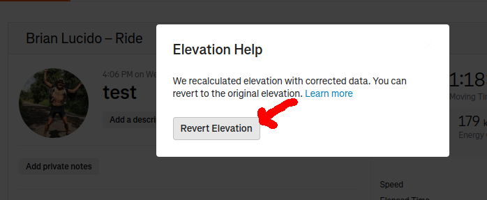

How to fix if Strava did not respect your elevation override
IMPORTANT NOTE!! Even after using GOTOES Elevation Override, Strava Might Override Your Elevation Anyway!
Step 1: Make sure that you exported from GOTOES as FIT and not TCX or GPX (GPX does not support total ascent, and TCX is not "trusted" by Strava). Also, make sure that the device you selected when exporting from GOTOES is a barometric device. For example, the "Garmin Fenix 6" has a barometer and is "trusted" by Strava. The "Garmin Edge Touring" is NOT a barometric device, and will therefore have its elevation overridden by Strava no matter what.
Step 2: Go to the 3 dots and select "Revert Elevation"
Select Revert Elevation.  If you have the option to Revert Elevation, that means Strava did an override anyway.
Step 3: Click the button that says "Revert Elevation"
Next click the button to accept the elevation reversion.
Step 4: Now you will see that Strava will display the GOTOES assigned elevation. Strava is always eager to override your elevation, so this is how you can overcome that.
Back to 82 feet of climbing after Strava calculated it to be 297 feet.
