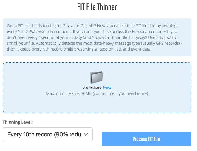

    Is your file too big? A FIT file larger than about 10 MB will usually be a problem for many platforms. Some devices, such as Wahoo start to have problems once the files exceed 5MB. Here is the tool to thin out your FIT files and here is the tutorial on how you can shrink them.
    The FIT File Thinner will remove extra points in your file - but don't use this tool unless you know that the problem is that your file is too big.  Too big is a FIT file size more than about 10MB or so...

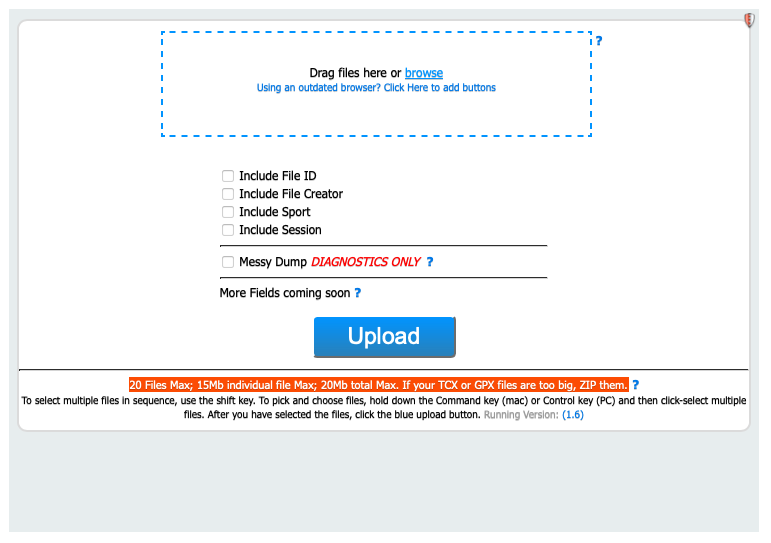

  2. Corrupted FIT File (option 1)
    If the problem is not the size of your FIT File, then it might be corruption. There are many types of FIT File corruption. The header can be corrupted, the various records can have the wrong base type, there can be a frame-shift... GOTOES can automatically repair many of these types of problems in the Merge Tool. I know it's called a merge tool, but it is dynamic, very powerful, and can accept single files as well. This tool takes your FIT file(s) and rebuilds them from scratch. You can export to GPX or TCX free - for import into your favorite app. If you export as FIT, your exported file will include most (but not all) of the standard FIT file fields. Here is a list of the supported FIT file fields.

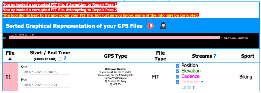

    Here is what the GOTOES Merge tool interface looks like when it finds a corrupted file.  The tool automatically repairs many types of corruption.  But if it can't resolve the issue, move to the next step...

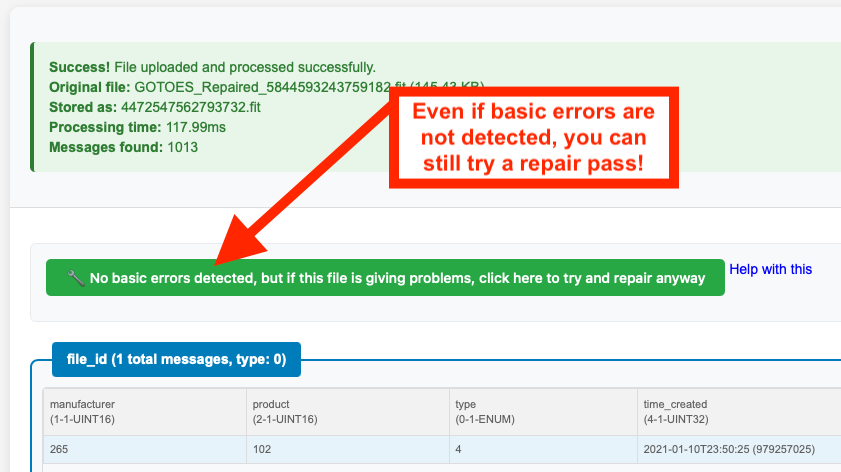

    If steps 1 and 2 above failed you, the next thing you should try is the GOTOES Fit File View and Repair Tool. This tool will allow you to see ALL of the raw data inside your FIT file. GOTOES will identify items that are part of the standard FIT File definitions - and those that are not. You should not worry if you see items that are not part of the standard definition; Garmin has not yet documented everything... but if you see type or size mismatches, that MIGHT be part of the problem. After you load the file, there is a REPAIR button that is shown, and if the above options failed, you should use this repair method. This button is aggressive, so after using it, you may lose some of your FIT fields - but the important data like your map, heart rate, cadence, power, etc. should all still remain. Currently it only handles smaller files, but you can shrink first (above) and then do a repair. I'm hoping to improve it to parse larger files soon!

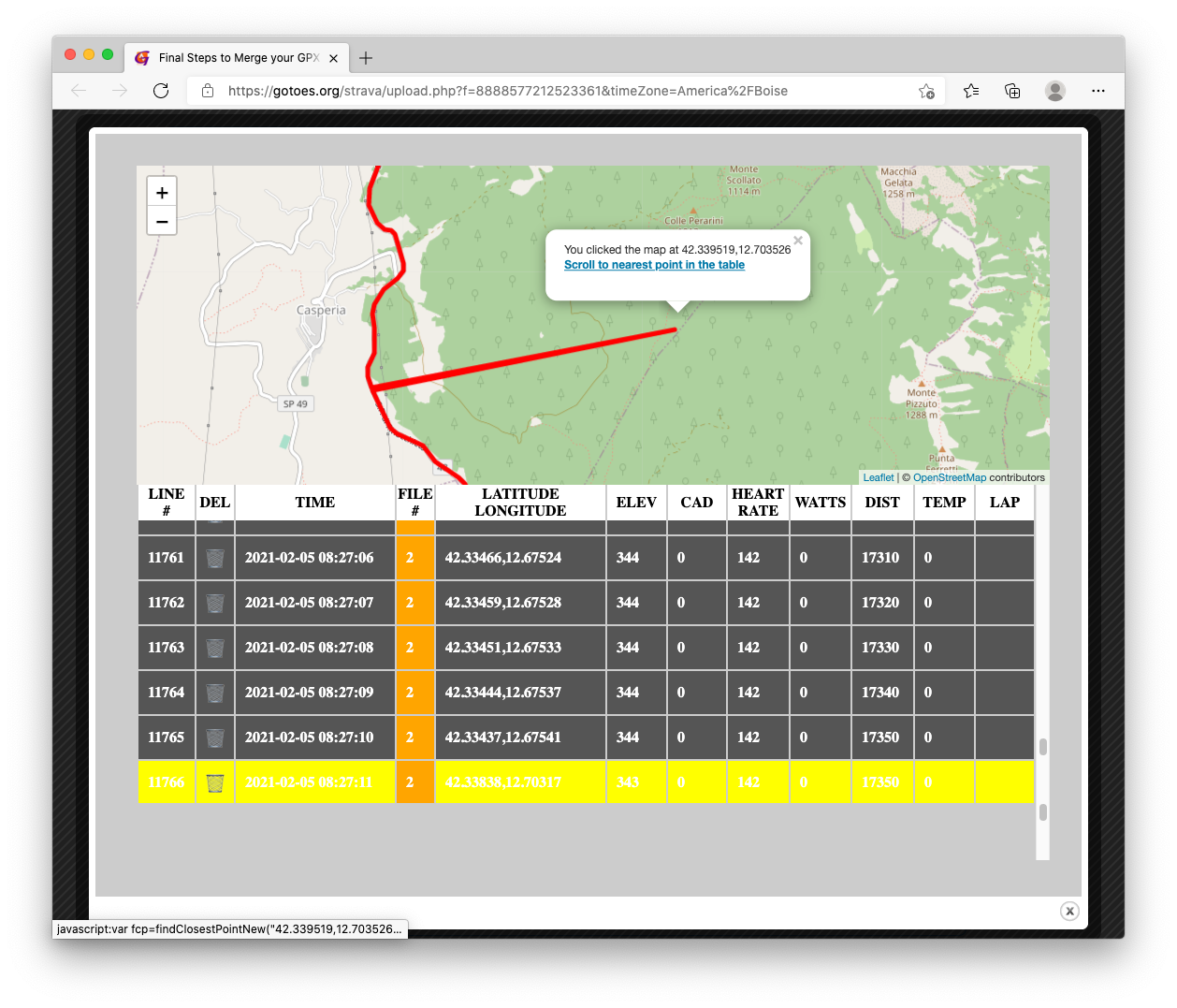

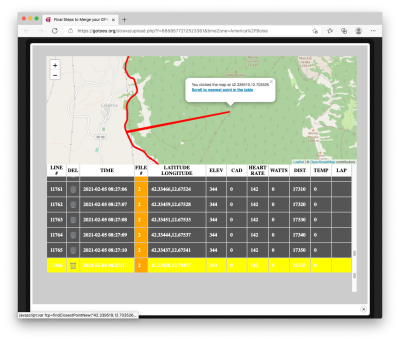

    If steps 1, 2, and 3 above did not resolve the issue, we need to ensure that the problem is not errant points or timestamps.. If you have a timestamp that is in the future or in the past, you're going to need to delete it with GOTOES. Here is how to delete errant timestamps. Sometimes you will get errant points in the wrong GPS position. Here is a tutorial on how to delete errant position points with GOTOES.
    GOTOES allows you to manually edit errant points.  If it is just one or two points, this is a good way to resolve issues (such as when your map has a line going out to Timbuktu.  It's also a good way to delete a couple of timestamps far in the future or the past.  This is not the preferred way to handle other types of corruption, but for single point issues, it is the optimal solution.
