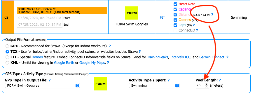

STEP 1:

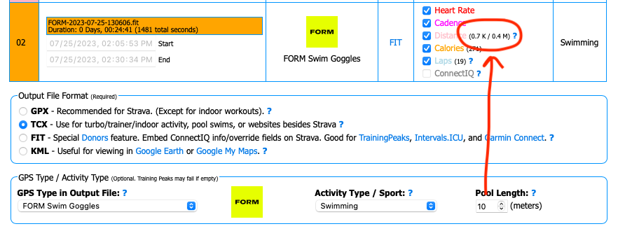

Upload the FORM Goggle file to GOTOES. Notice the calculated distance when I supplied the information that this was a 50 meter pool.

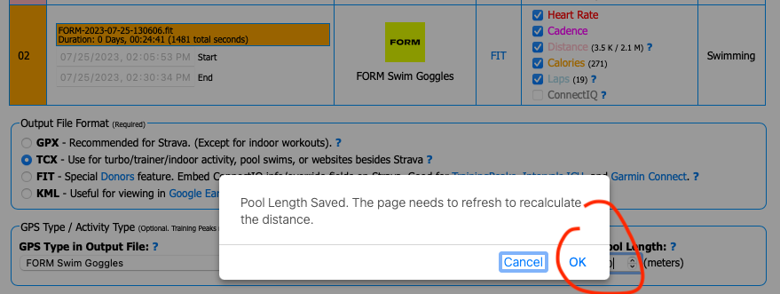

STEP 2:
Enter the correct pool length. In this case, I told the tool that the pool was 10m long. When I "click away" from the box, I'm prompted with a confirmation that the page will reload with the new distances. The tool will also save your pool length preference in your browser cookies so you won't have to enter it again. Note that the tool will auto-apply this length in future distance calculations if your files are missing pool length/average speed in the future.

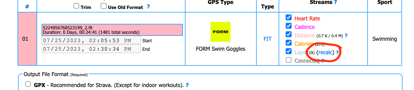

STEP 4:
If your source file is also missing distance in the laps, you will want to click the "recalc" button in order to re-calculate the lap distances. This will take existing laps and re-apply the time/distance to the correct values. You will probably only want to use this feature if you have empty distance values, which was the case with the FORM goggles.

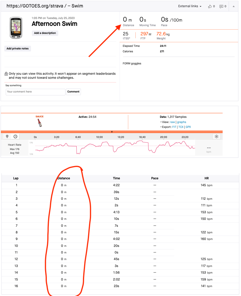

FINAL RESULTS: BEFORE:
This is what the original file from the Goggles looked like

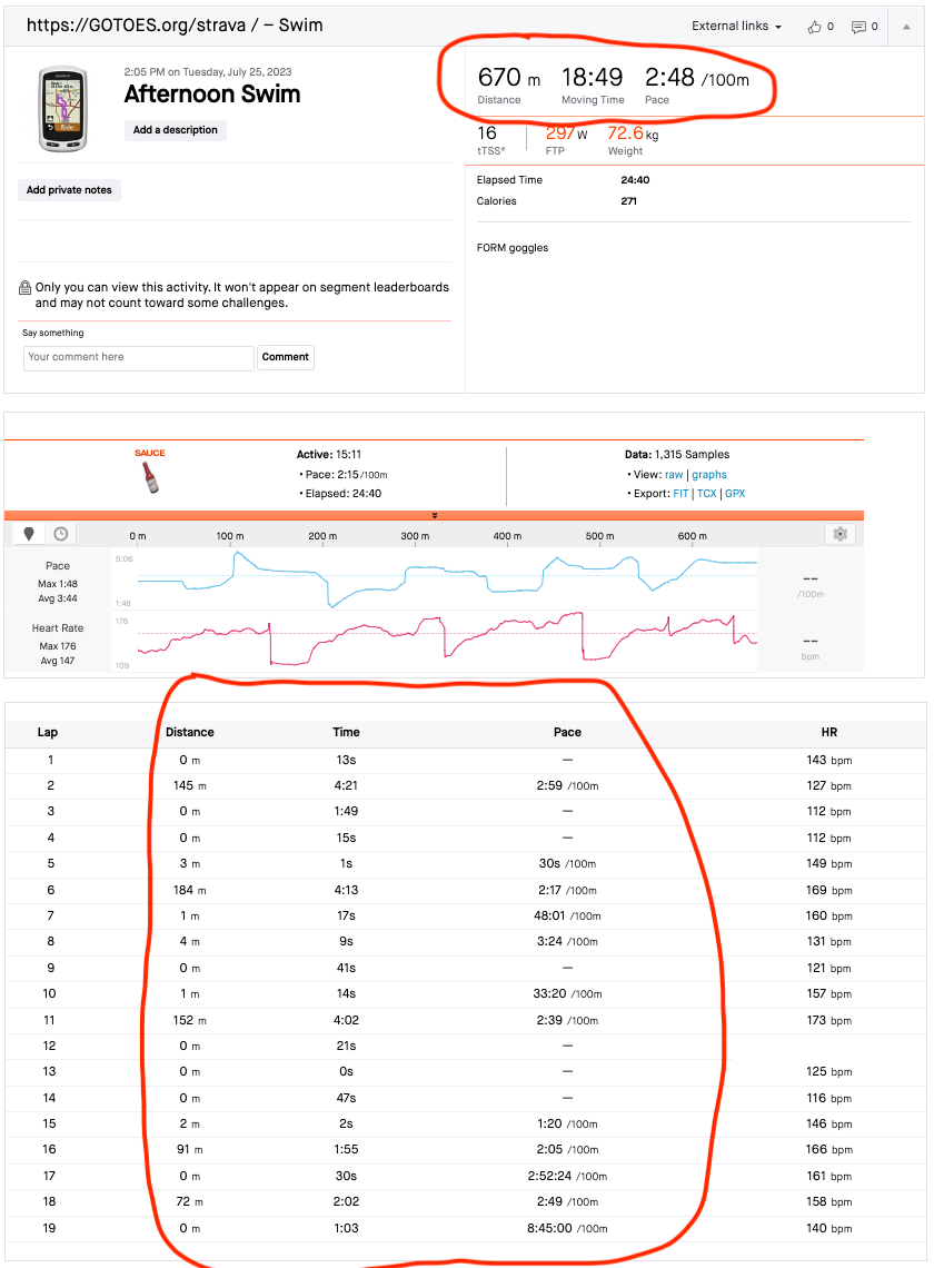

FINAL RESULTS: AFTER:
This is what the swim activity looks like after processing using GOTOES.
